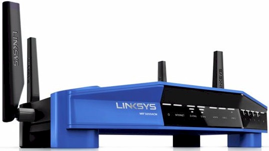

Linksys' WRT3200ACM AC3200 MU-MIMO Gigabit Wi-Fi Router is another example of a router with technology waiting for devices to catch up with it.
Read on SmallNetBuilder
It would be interesting to see a comparison between the WRT3200ACm and the WRT1900AC/S since as you mentioned in your review that the WRT32000ACm is an expensive 1900AC router.
The DFS feature would be nice to have, the price is perhaps bit high at the moment.
I've been using Total Simultaneous TCP/IP and UDP throughput as performance differentiators in the V4 process. The comparison charts of AC1900 class routers show the WRT3200ACM suprisingly low in the ranking. Table 2 above shows unidirectional throughput isn't particularly high either. I suspect this is due to the relatively high number of retries for the TCP/IP tests and packet loss for the UDP benchmarks.
The top-ranked D-Link DIR-879 had 23 total TCP/IP retries in the bi-directional test vs. 18,013 for the WRT3200ACM. Packet loss for the bi-directional UDP test was 50% down and 61% up for the Linksys vs. 0.01% for both directions for the D-Link.
Looks like a SW/config issue inside the Linksys firmware with flow management and backpressure - Since the WRT3200 has a new switch asic compared to WRT1900, could be a simple tuning there...
Nice to see that the test case and platform caught this...
