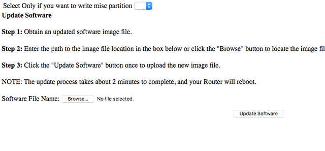

Interestingly when I have it plugged in to my laptop via ethernet and go to 192.168.1.1 on my browser I get taken to a webpage asking me to update the software. This isnt the usual ASUS GUI. I tried updating the firmware through the webpage but I still have the same problem. I wonder if its a different issue and not the PSU?
@Shas95 upload a current firmware and let it be for at least an hour or more. This process is very slow from the recovery UI.

So that is a "recovery UI"? Under what circumstances does it present?
