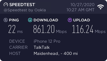

I have the Netgear RAX200, which is Netgear's version of the AX11000 minus the gaming features. This is what speeds i'm seeing on my 1 Gigabit FTTH line:
iPhone 12 Pro (2x2 AX)

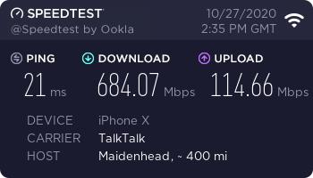

iPhone X (2x2 AC)
