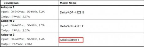

Please tell me the dimensions of the DC connector - "Outer Diameter" mm * "Inner Diameter" mm DC Adapter ASUS RT-AX86U

Very old thread, but I've been trying to find this out too, so I can power my AX86U with USB-PD. My power brick is the ADP-45ZE B. Every source online says the connector for that is 4.0x1.35 but for my unit at least that's not the case. I bought a 4.0x1.35 adapter and it didn't fit. So I started trying every barrel connector I had lying around and the one that worked was a 5.5x2.5mm. My unit was purchased in the UK.
So depending on country or even batch, you may have a 4.0x1.35, a 5.5x2.5 or something else. May be worth investing in some calipers to know for sure.
