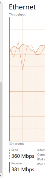

Below is 300Mbps with symmetric transfer
Peak down 381 and up 350ish
