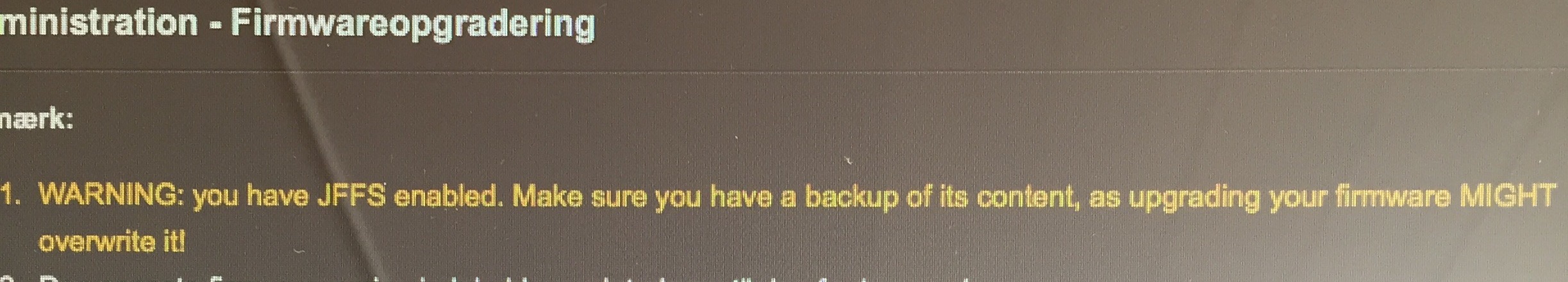

What is JFFS ? Do i turn it OFF or what
JFFS is a file system in flash memory meant to store small files (like scripts and configuration files). If you don't know what it is, you probably don't use it.
