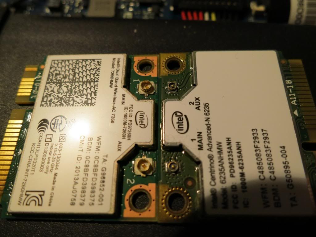

im not very good at this.. could someone verify if i am checking them right?
which i need:
- 2 adapters for current antennas: this one
- new card: 7260 pdf, e.g. : amazon. 7260xxx (i think xxx should be HMW?)
this is the current one: 6235 pdf
i found a another pic from the card u500vz has:
http://www.notebookcheck.net/fileadmin/_migrated/pics/37_wlan_02.jpg
- screwdriver: T5 "Asus uses Torx screws, which require a special T5 screwdriver."
comparing: http://ark.intel.com/compare/75439,66890
Edit. let see what happens... just ordered them. =}
Sent from my iPad Air 2 using Tapatalk
the card arrived (connectors/adapters still missing) but i used a tape to connect them for the time getting those adapters... anyway...
the linkspeed is near the rooter 867mbps and transfer r/w is 49-50 MBps =)
links speed is dropping fast though when you are further from the router. couple of meters away and the linkspeed is dropped already to 300mbps :/ could be the reason that antennas are not really connected well, only touching the plugs...
adapters didnt fit, so i have no idea about the right adapters... anyway, i open them alittle bit to able to use them... the linkspeed is around 700-867 between the laptop and the router (2-3 meters). =}
