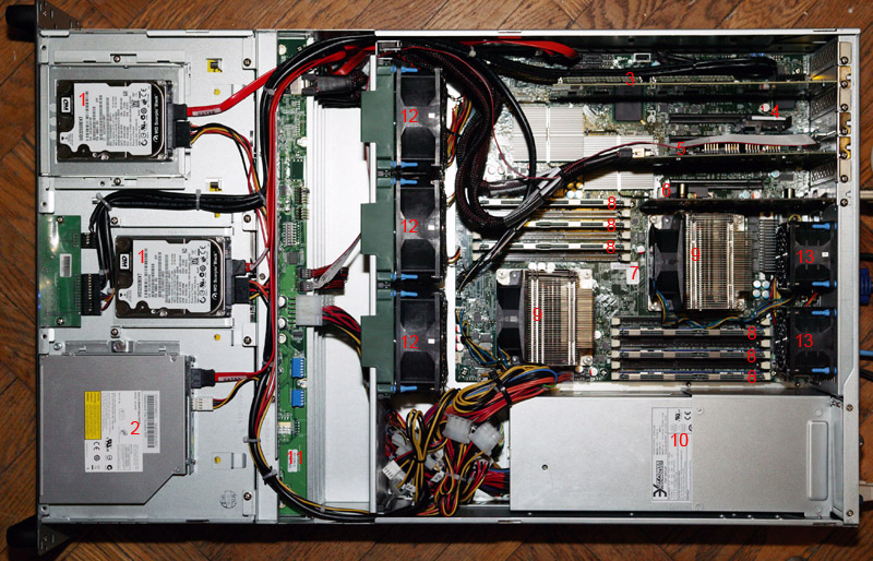

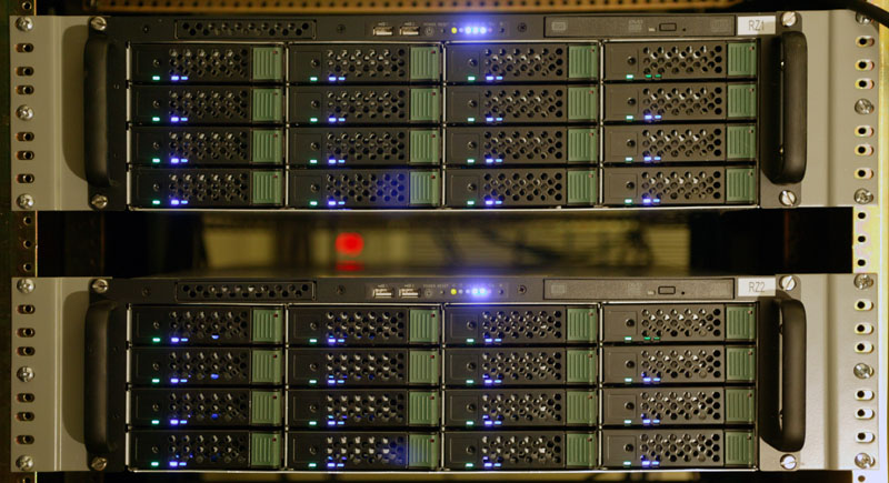

It only made sense for me to build my original RAIDzilla (2005) and my RAIDzilla II (2010) systems because I also build them for my day job. Currently the RAIDzilla IIb holds 128TB in 3RU (click on each pic for larger version):
