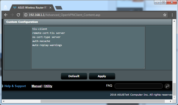

****Please take note there was an error for port 1198 using PIA Server.
I forgot to put disable-occ in custom configurations. It was indicated for AES-256 but not for AES-128
Please fix this otherwise there are 2 warnings 1 about mtu and the other about blowfish being used by the remote server.

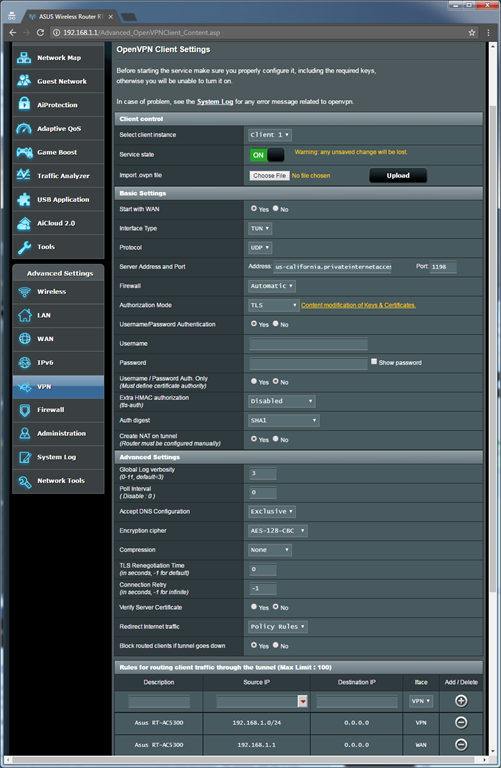

I added the disable-occ and it did get rid of the errors! Thanks so much! I just wanted again to thank you so much for all the time and effort you are putting in to save all of us newbies. You have no idea how much I appreciate it.
I am using the IP of PIA, and I'm not sure how I can check if I'm using PIA's DNS server. I tried changing the DNS on the WAN of my router, but after I input PIA's DNS, it cuts off my internet using DNS : 209.222.18.222 and 209.222.18.218. So I was left with no choice, but to change it back to the default.
Here are my router settings:
I added the disable-occ, but didn't get the latest screen print.
Everything seems to look great! I'm no longer getting any errors in my logs. Maybe I'm not using Wireshark correctly? When I turn on the PIA windows client, all the traffic from my desktop 192.168.1.xx goes through the UDP tunnel and I can't read any data. Once I turn the PIA windows client off and remove the desktop pc from the VPN policy routing from WAN. The PC is now going through the VPN tunnel via 192.168.1.0/24 per your advice. Then I used Wireshark to capture the same desktop IP of 192.168.1.xx. Data travels through a lot of other protocols and not UDP and I can read the text in some of the packets. I will have to include some screen shots when I get home from work tonight.

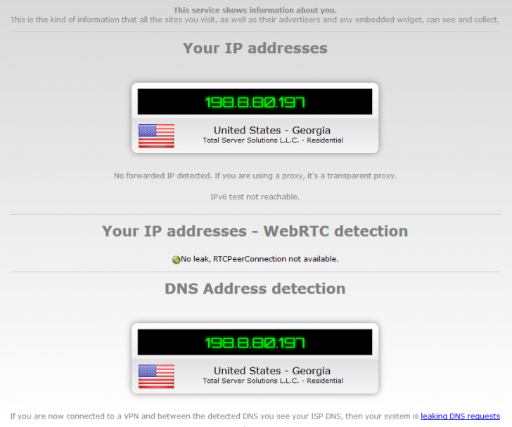

everthing looks right on your setup
Don't forget that disable-occ
when you connect using the router go to https://ipleak.net/
look at the IP address you get. it should not be the same as your local ISP address
you should have an IP from PIA with a DNS being the same as PIA
if you have that then you are good to go.
Not sure about wireshark but I tried the legacy and it seemed to show PIA address.
Make sure you do a DNS test for the IP and then you are good to go.
if you still have problems let me know

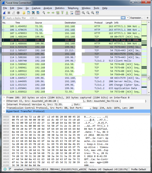

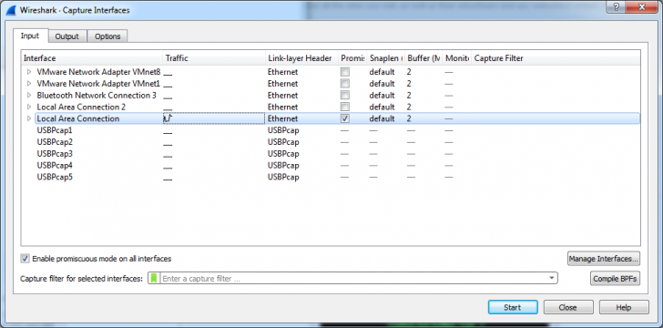

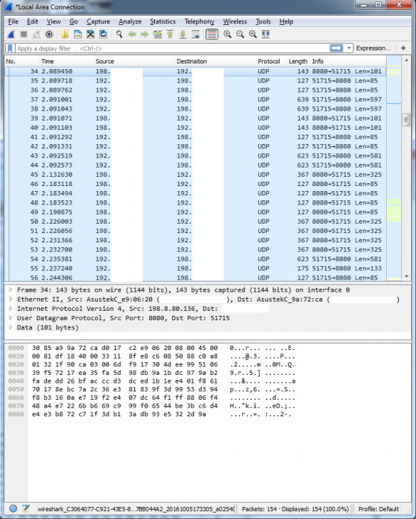

Using Wireshark here is the local area connection that I chose highlighted in blue for both tests.
Here is the results going through the PIA VPN on my router with the PIA Windows client software disabled. .
Here is the results going through the PIA client software on my Windows PC with the router VPN disabled
This makes me believe that I am anonymous and going through the VPN tunnel with my router, but none of my data is encrypted.

Not sure about your results because I only see one image so I can't see the difference.
Also when you use wireshark with the win PC and PIA software it reads the packets directly from the PC
but you need to get wireshark to go between the WAN traffic and the modem in order to see what gets encrypted when going out from the WAN which you are not doing now.
From what I see your setup is working ok.

lol... opps... sorry! Here is the other screen shot using the router VPN.. I see what you mean.... I guess there is no real way to test the router VPN encryption. If there was a way, I would love to test it. I actually have a few servers at home that I don't leave on all the time, and when I do, it's nice to use the WOL feature in the router so there is a way to get to my data when I am traveling. With the VPN on, I wasn't able to find another way to access my router. If my servers were powered on and running through the VPN, is there any way to access them if both my router and servers were going through the VPN tunnel? Or is the easiest way is to set them both to WAN? I can't access my router and servers with my DDNS when the VPN is enabled.
I just noticed these errors in the VPN log. I tried researching it, but couldn't find anything on these errors...
Oct 5 20:06:54 openvpn[6816]: ERROR: Linux route delete command failed: external program exited with error status: 2
Oct 5 20:06:54 openvpn[6816]: /usr/sbin/ip route del 198.8.80.13/32
Oct 5 20:06:54 openvpn[6816]: /usr/sbin/ip route del 0.0.0.0/1
Oct 5 20:06:54 openvpn[6816]: /usr/sbin/ip route del 128.0.0.0/1
