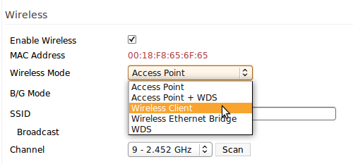

    It's unbelievably simple to do it with other firmwares... Tomato has been great for me. There is a drop down box that lets you select what wireless mode you want:
    [​IMG]
    Too bad the manufacturers don't support it though. It doesn't seem like it should be that difficult to implement.
