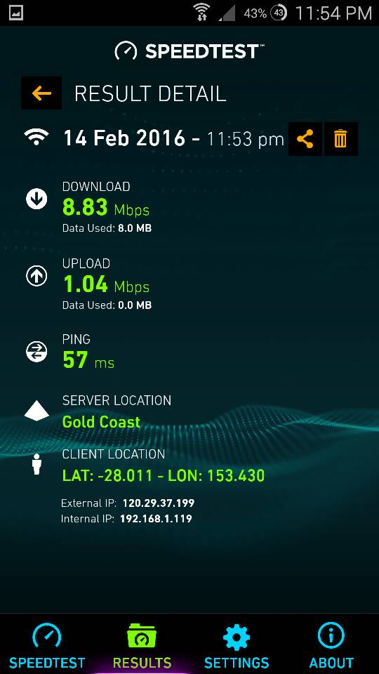

Yes, I know mine looks shocking and that probably isn't a true reflection as it was done on S5 on the 5g and a few rooms away from router (block walls).
As the box is hooked directly into the router via a Gigabit Ethernet switch.. So overall uploading say a few 20-50meg files only takes about 10 minutes to gdocs..
So as I have 50gig to use on gdocs, I can keep most of the heavy lifting off my system here.
For now the PPTs/PDF's and videos are all running of gdocs well..everyone that is using are happy with the speed they are getting..so that's good..
I need to run some speed tests once I am out and about back to it and see for myself..
