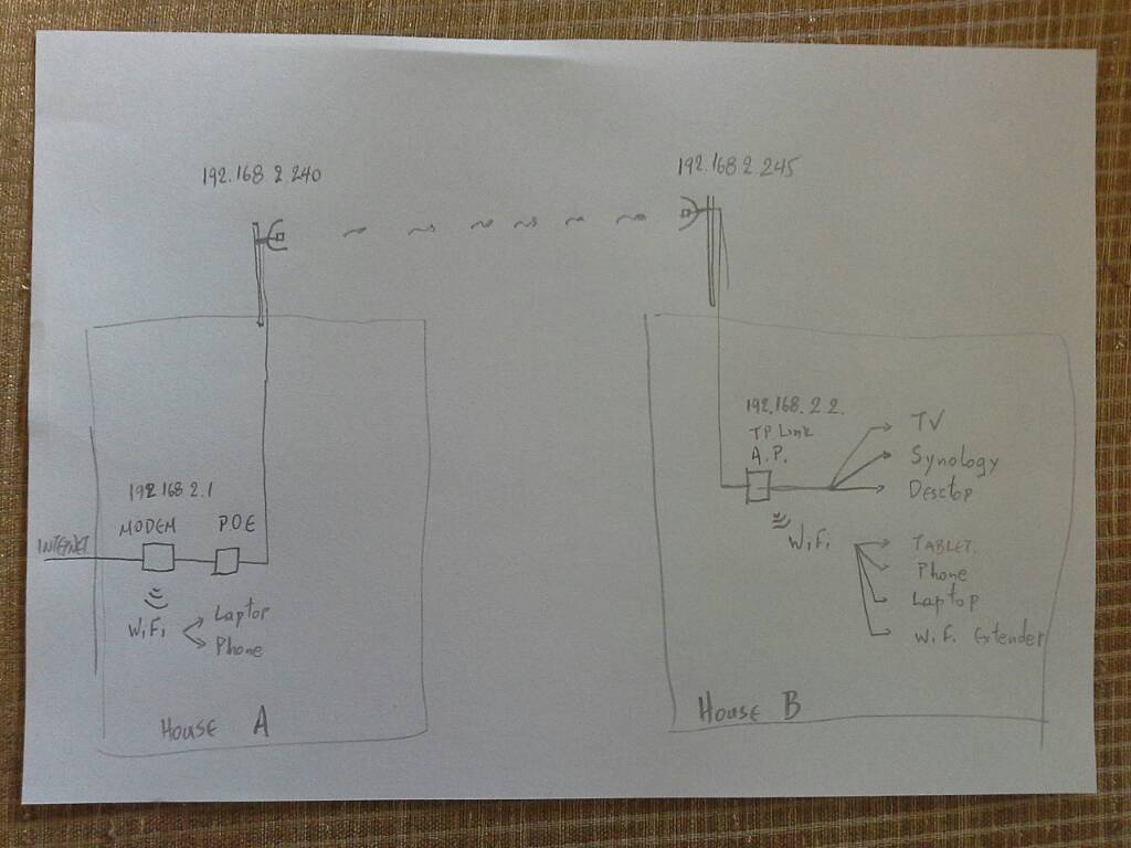

I live in a place where I can't have wired Internet. For that reason I contact a friend and he suggested me to go wireless with a ubiquity antenna. And that i did. That friend of mine works in a company that specializes in networking dut in a different city. He pair the two antennas and did all the configuration. I install the antennas and everything worked fine. After while the router in the house A started the wired thinks. While a had WiFi I didn't had Lan. The router was a Philips from an old Internet provider.
The router in the house A provide all the ip's. So I didn't have any network in house B. I change the router to a Tomson also from a provider. For a few months everything worked fine. after while this router started to do the same things. Wen I remove the cable from the router and pout it back again I had network for a few days. Then again the same. I bought a TP-link and I have the same problem. After 7 months I didn't had Lan but the WiFi worked great. After that I use a ZTE router also from an Internet provider. And again the same problems.
Now my friend who can't come and inspect it due the distance suggested to me to buy a microtik router but am skeptic because I don't won't to give some money and have the same problem.
Is the router or Is it posible to blame the POE ?

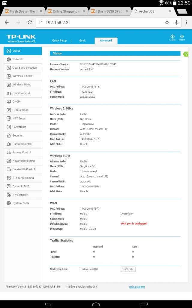

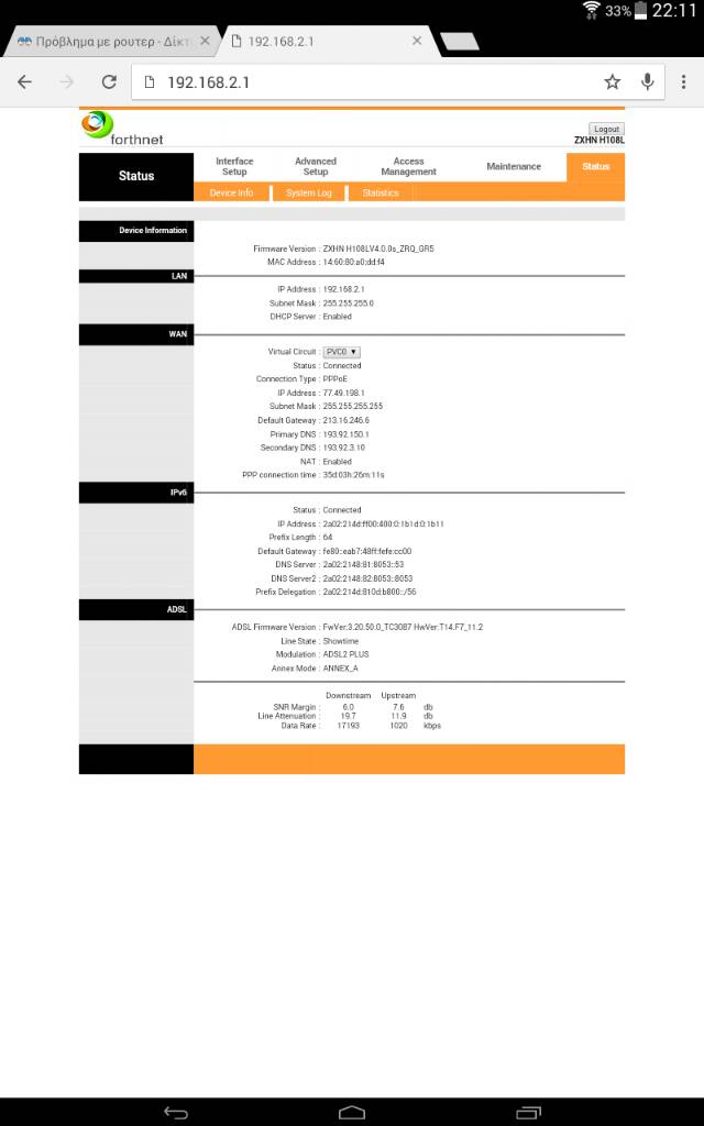

Your description is a little tough to follow, but I'll take a shot.. :)
You show the router in House B as 192.168.2.2. I assume that is its WAN IP. What is the House B router's LAN IP address. And what are devices in House B getting for IP addresses (include IP, Gateway and DNS, please).

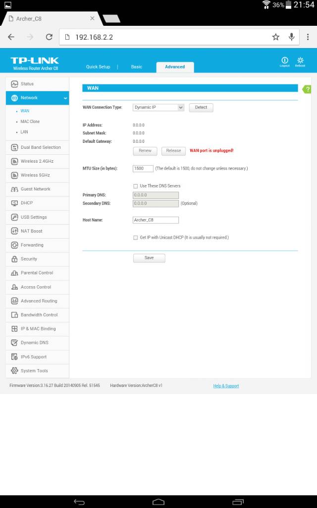

The house B only has a access point. The Wan port is not connected. I only use the moden-router in house A for ip. All the devices have an ip like 192.168.2.35, 192.168.2.45, and dns 255.255.255.0

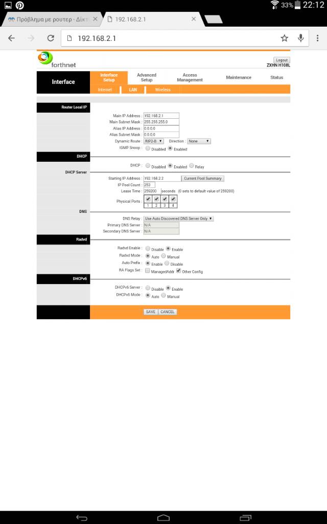

Is the DHCP server disabled on the router that you are using as an AP?
When the network in house B goes down, can you plug an Ethernet device directly into the AP and does it work? You may have to set a STATIC IP on the device you use to check with.
Yes the DHCP is disabled. When the network is down and I plug a device I only can access the net if I use a static ip. My problem is why the router in house A disables the Lan. Is because it gives all the ip?
You could check the DHCP table to in the router to get the answer to that question. What DHCP lease time is set?
When you say you change the routers from Thomson > TP-LINK > ZTE, is that the router in house A or the AP you are using in house B?
When I connect from house B with a ethernet cable when the network is down I can see the two antennas but I can't access the router in house A.

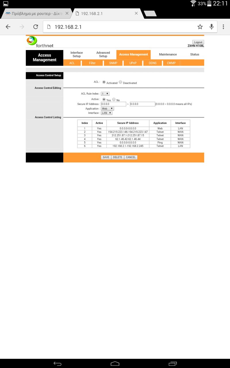

So you physically run a cable between the houses and plug it into the router in House A and you can ping / control both Ubiquiti bridges at 192.168.2.240 and .245.
But you can't reach the House A router 192.168.2.1. Can you reach the House B AP at 192.168.2.2? Can you reach any other devices in House A or B? If you can't reach them, what do they show for IP address?

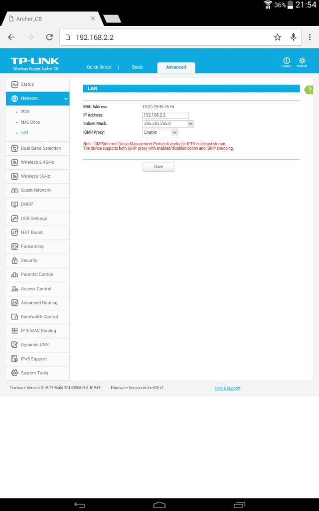

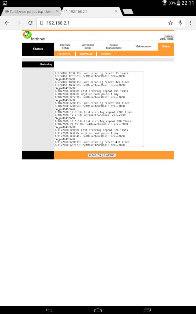

Can you click on the network section on the left and send in a screenshot?

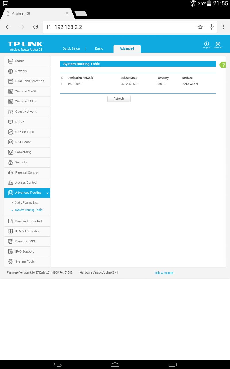

also, please show us if there is anything under advanced routing.
Well I didn't explain correct. I don't have the possibility to run a wire from house A to house B. If the Internet is up and running then all the networks work fine. Sense the router in house A gives all the ip's all works. When for some reason the router closes all the Lan ports then all the network stops working. I can use static ip's in the devices in house B to work with but I don't have Internet in the house B. I didn't make the network in house B subnet if this is the correct word because I won to see the Nas drive from house A.
When the Lan ports of the router in house A are closed then from house B I can connect to the access point with a static ip and I can also see the two antennas, but I can't access the router in house A.
From the information you provided, there is nothing wrong with the House A to B wireless bridge. The problem is your router in House A is locking up.
I'm not sure what is causing that, but I'm guessing it could be you are exhausting your DHCP pool. The Pool count is set to 253, but you have three static IP addresses (192.168.2.2, 192.168.2.240 and 192.168.2.245). If the DHCP server isn't smart, it could be assigning duplicate IP addresses and causing problems.
Adjust your DHCP server starting IP and pool size so you don't run into the static IPs you have set. Better yet, make IP reservations for those static IPs in case your router isn't smart enough to check whether an address is used before it assigns it.
The LAN DHCP server lease time is set for 30 days. I would also reduce that to 24 hours (8640 seconds), or a few days at most. This will ensure IP addresses get reused as devices come on and off the network.
