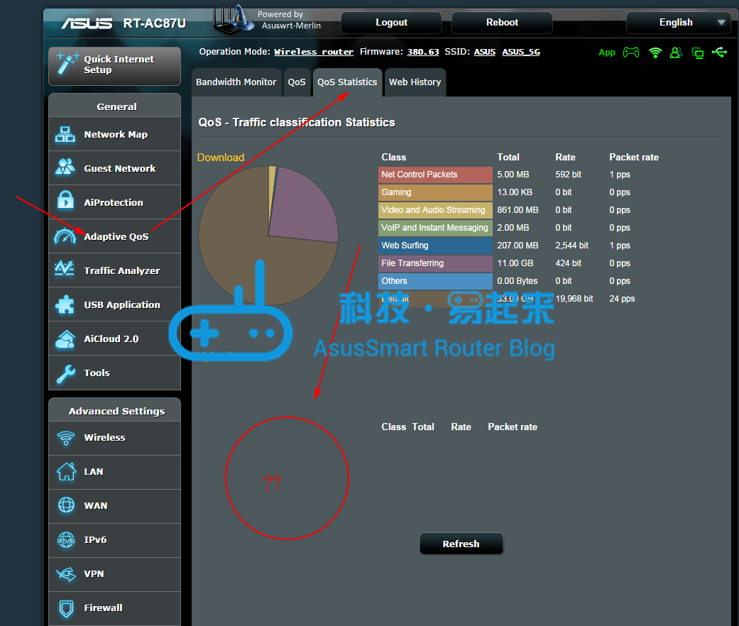

When we press the "customers" button, we see the following:
And when we press the button "View List" see a blank window. Why?
Asus Rt-AC87U, 380.63
By interface
