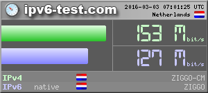

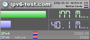

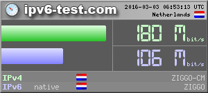

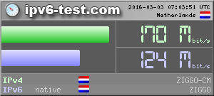

Hmm so I was testing this today on my 87U, and while I don't think SpeedTests are the greatest test, for me turning off all the AiProtection features does seem to help but only for LAN clients. For everything going over 5Ghz WiFi it makes no difference, in fact it's still faster than LAN even :p Weird.
I ran each test 2/3 times and they were pretty much the same every time.
IPv4 stayed about the same on all tests.
*EDIT: See 5Ghz results in next post. Can't post more than 3 images at a time.
All AiProtection On - LAN
All AiProtection Off - LAN
And the 5Ghz results:
All AiProtection On - 5Ghz
All AiProtection Off - 5Ghz
