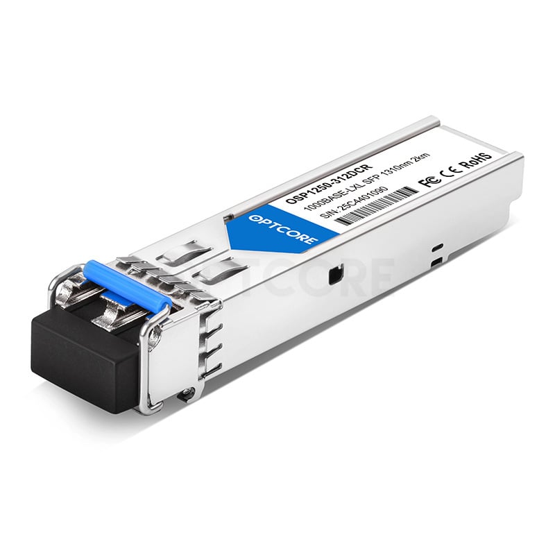

Generic Compatible 1000BASE-LXL SFP Multimode 1310nm 2km Transceiver (OSP1250-312xCR)
www.optcore.net
62,5µm MMF/OM1 1km - 50/125µm/OM2 2km 50/125µm

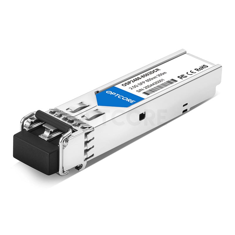

Optcore 2.5G Multi-mode 850nm 300m SR SFP Transceiver (OSP2488-8503DCR)
www.optcore.net
300m transmission with 50/125μm MMF

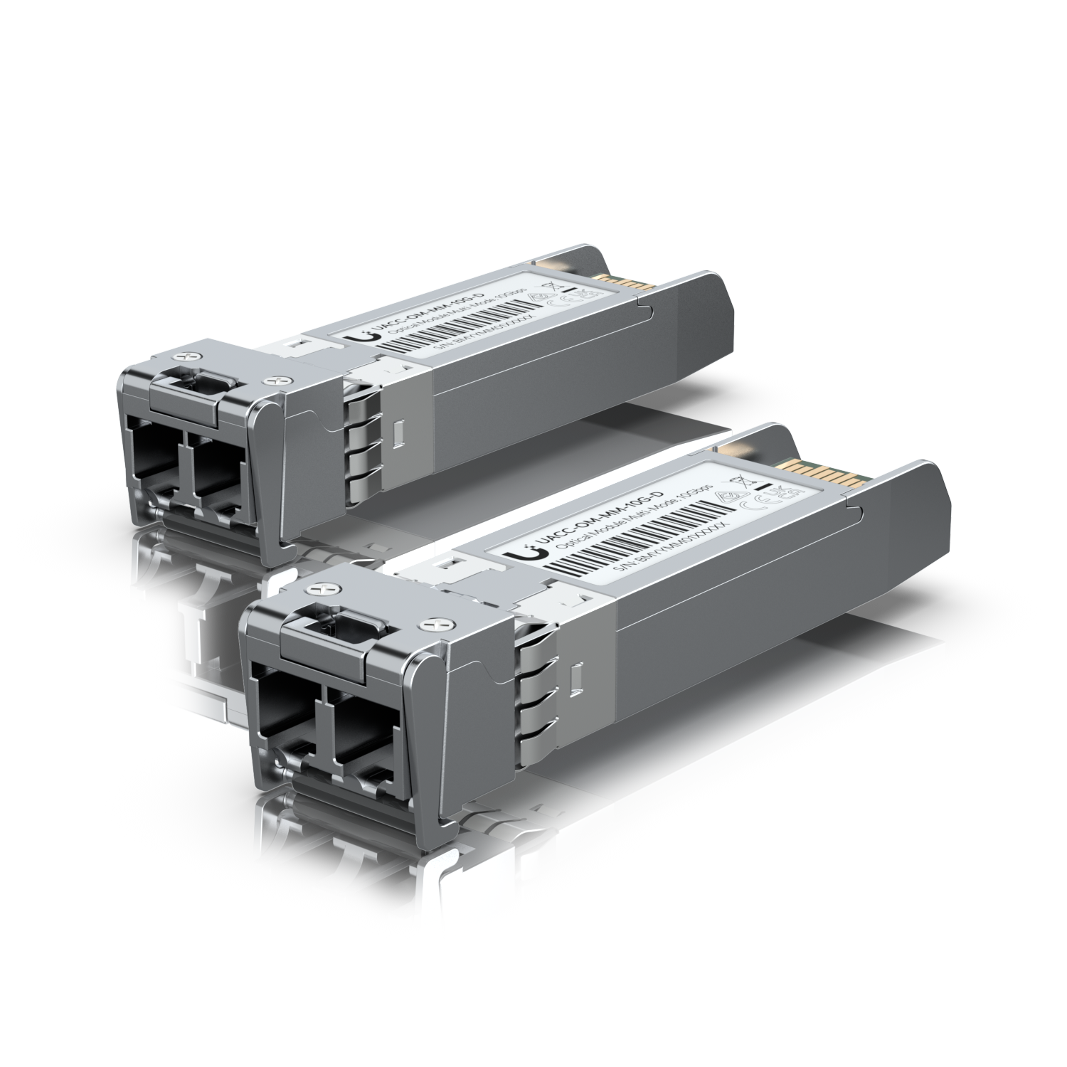

300meter / 984.3' (850nm) but dont say what MMF
Ubiquiti Unifi 10G Multi-Mode Optical Module (UACC-OM-MM-10G-D)
store.ui.com

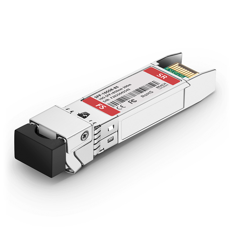

All 10Gbps FS modules
220 meter (850nm) and 300 meter (1310nm). But mentions OM3 and&or OM4
www.fs.com

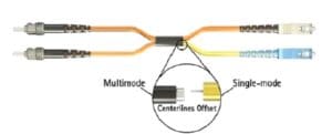

Mode conditioning patch cord
Information about these cables
edgeoptic.com
