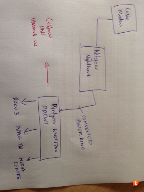

Can you upload a drawing of how you currently have it set up and how you want it set up?
I have created a rough drawing of what I want.
Basically Im outside USA and want to use services like netflix. I use unblock.us to achieve this.

What is the outside interface IP address on the DD-WRT router? This is the power line interface.
If it's an internal IP, you can turn the DD-WRT out of NAT mode and into routed mode, then on the primary modem, add a route for the other network (the one behind the DD-WRT router) with the DD-WRT's power line interface as the next hop.
The power line does not have an IP address. It just allows an Ethernet connection. The IP address is with the netgear ddwrt. Right now I have given the ddwrt ip as 192.168.5.1 while the nighthawk has 192.168.1.1. This way it works fine but then there is no sharing between the routers as they are on different networks. I want them to be on the same network

192.168.5.1 and 192.168.1.1. Your mask should be 255.255.0.0 if you want them to be in the same subnet.
You should block dhcp request from the wan port of your ddwrt router and let dhcp server running on your ddwrt router.
That way, all device asking for ip will get one from router's dhcp server connected with. If you dnsmask it working with your ddwrt, all device connected to it will use your custom dns
Wouldnt it be easier just to enter the custom dns manually into the devices that you want to use unblock.us for?
Crazy you make a good point now that I think about it, it would be simpler
