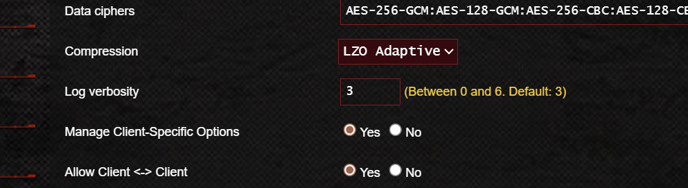

so i am running an older server still and have not upgraded because it is remote and i still have a full time openvpn tunnel running.. i do have this setting (compression) on.. if i upgraded will it break my tunnel and not work till i upgrade the client as well
A good question about how the update works--is an existing server changed, or is the parameter moved to the box?
In the meantime, a mismatch in compression means the tunnel sets up but no traffic moves. Also, it is useful to have a second remote server instance set up, so that you can reach the server over a different path. That way you can change the first remote server configuration if you need to.
