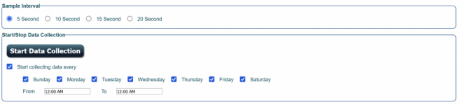

Is this what you mean:
If so I did that a day or so back. However I just discovered found that if I selected the 2.4GHz channel all the other routers in the neighbourhood were found:
selecting 5GHz showed only this:
Maybe the 5Ghz channels signals from the other routers are just too weak to detect.
