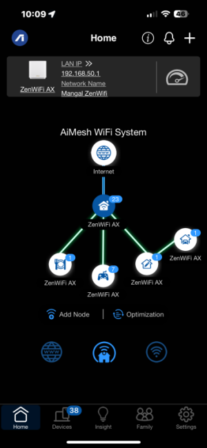

Ok, so I was still having issues, so I took the ET8s out of the equation. Now I only have the 5 XTs running… why is that one piggy backing off a node instead of the main?
Because it sees a stronger signal from that node. To work around this, you can "force" that node to connect to the primary by rebooting the node it is currently connected to. While that node is rebooting, your wayward node will seek another backhaul connection and should connect to the primary. Once it does, go into the wireless log on your primary and look at the RSSI levels and connection rate of all your nodes. The node that previously was daisy chained will probably show lower connection rates and an RSSI above -70. Despite this, the clients connected to that node will probably still experience better performance than they would with an extra router hop to get to the Internet.
