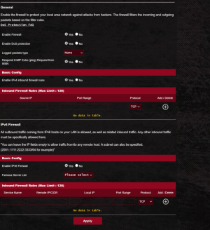

Respond ICMP Echo (ping) Request from WAN pinging tunnel enabled.

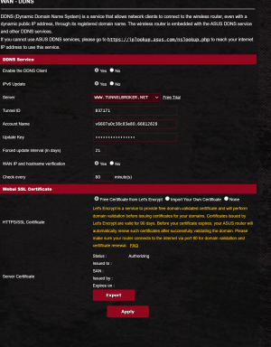

You don't need to use a script, the DDNS option in the GUI is all that's needed. As per the wiki, you only need to use a script if you can't use the DDNS GUI option because you're already using it for something else.
@vanhelsing1616 Your screenshot is too small to read, but I think you may have some typos. Check the "LAN IPv6 Prefix" field, I think it's meant to be "2001:470:b:230::1". Your "Server IPv6 Address" may also be wrong but it's too small to see.
the gui dddns gives me a request error.
i have used info for it right i believe.

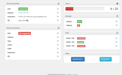

I'm not getting any ipv6 internet connectivity thru tunnel.

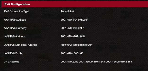

Your configuration is completely different now than it was before. Some of your screenshots show a /64 network and other screenshots show a /48 network. We cannot guess what changes you have been making.
Did you update the router's DDNS settings with your new Tunnel ID?
Look in the router's System Log for error messages when trying to start IPv6.

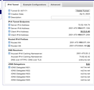

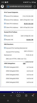

Which of the two HE pages contains your current details?
Stick to just one and make sure the client IPv4 address is correct.
