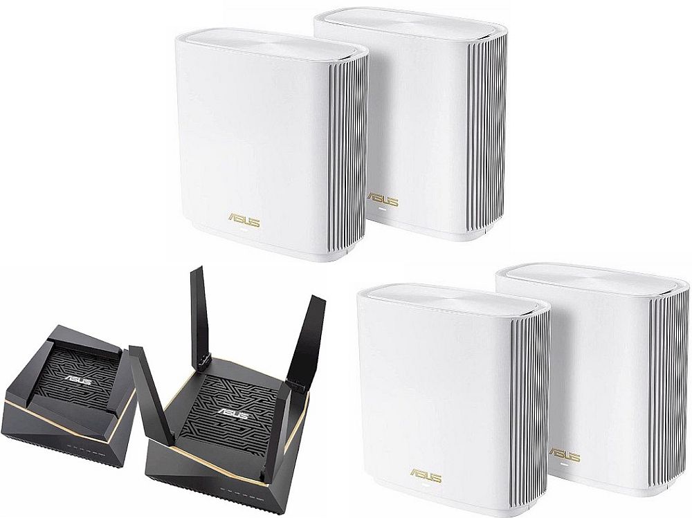

ASUS Mesh Roundup
We round-up ASUS' ZenWiFi 6E ET8, WiFi 6 ZenWiFi XT8 and WiFi 5/6 RT-AX92U into the ol' test corral for a ride.
Read on SmallNetBuilder.
