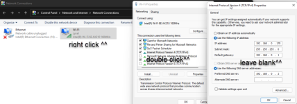

As to the static IP situation. Don't use the W10/W11 easy option. Open control panel / network / change adapter settings / right click on the LAN and hit properties and edit the IP info directly. The "easy" windows option is a pile of junk when trying to assess a network issue and doesn't allow for in depth configuration changes to troubleshoot issues.
