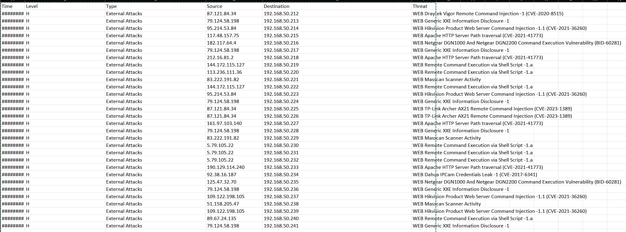

So I am getting a bunch of attacks I see in aiprotect. They seem to be from the same set of ips. I blocked these ips using iptables, but i still see the attacks coming from these ips - did I use the wrong commands, or should I see the attacks even after I blocked ips? I am on asus merlin, latest version.

screenshot of the attacks:
If the traffic is between a client and the remote IP, you should test the FORWARD chain. INPUT and OUTPUT are for traffic coming to or from the router only.
Any incoming traffic should be blocked by default, so if it’s a response to a client connection, it should be inserted early in the forward chain.
