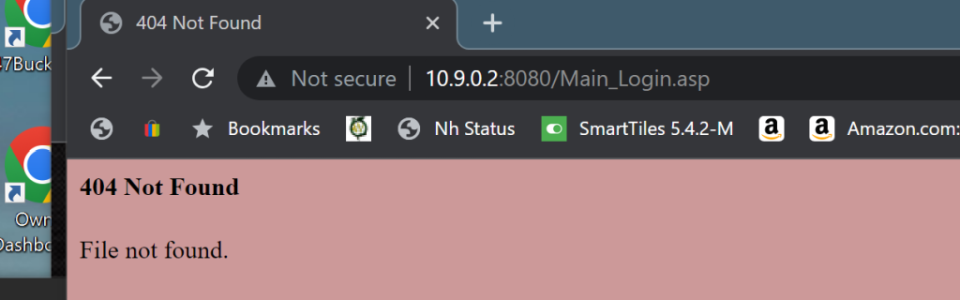

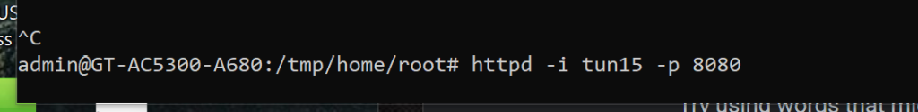

getting closer.. i am able to bind a web instance to the tun15 interface that the outgoing openvpn client creates but still not working correctly .. se below thanks

ok getting farther you can run the command after changing to the /www directory
ie
httpd -i tun13 -p 8080
and the web server works great over the ssh client ip (ie http://10.9.0.2:8080) from the openvpn servers remote network...
however when exiting the ssh shell that you started the command under it terminates..
