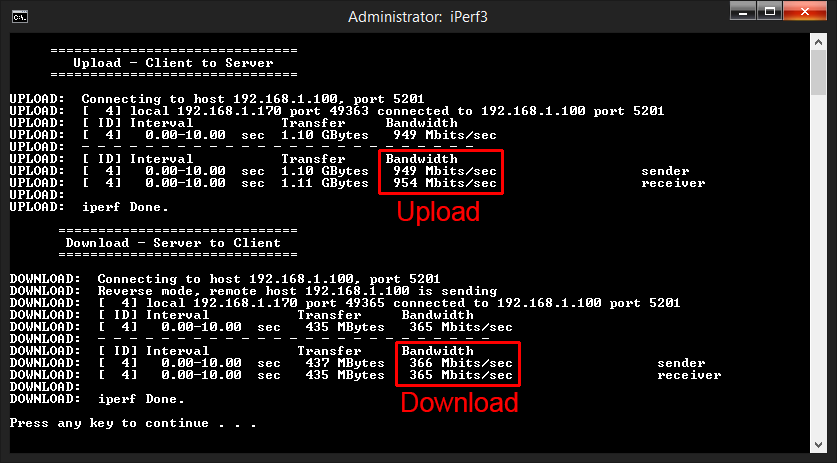

To keep things simple, and to provide what I would consider "ideal conditions" I decided to connect both of the ECB6200 Adapters to a 60' spool of RG6 Coax. Then one adapter is plugged into the LAN port of my laptop via 3' of CAT6 cable, the other is plugged directly into the LAN port of my router via 3' of CAT6 cable. My desktop is also plugged directly into my router via 3' of CAT6 cable as well.
Testing was done using the latest version of iPerf3 v 3.1.3. Here is the command line syntax I used for testing...
iPerf3.exe -c 192.168.1.100 -t 10 -w 1M -O 3
-t: 10 second duration
-w: 1MB Windows Size
-O 3: Omit the first 3 seconds of testing (to allow a warm-up)
As you can see, the upload speeds look amazing! However, the download speeds are about 2.6x LESS than the upload speeds! If I plug my laptop directly into my router (bypassing the ECB6200 adapters) and the run the test again, I get a solid 970+ mbps Upload AND Download speeds. So obviously that only leaves the ECB6200 adapters to blame.

Yeah but I don't see any of the iPerf parameters being the issue seeing as how I was able to get 950+ mbps Upload. I ran the test exactly the same way just in Download (reverse) mode. iPerf sent the packets the same exact way for the Download test as it did for the Upload test.

1. I already tried that during my original testing which got me the same exact results from both machines. The Upload being ~350 mbps and the Download being ~950 mbps.
2. I retested using the "-P 10" switch which did net me ~940 mbps in both directions, however, it makes absolutely no sense to test using parallel streams when the majority of tasks and applications aren't going to be using parallel streams when uploading/downloading. I'm more interested in real world results, not the fastest number I can obtain via a synthetic benchmark.
3. Server window shows the same results that the Client window shows.

In any case, back on topic. I checked the Node Info page on each of the adapters to get the Physical Rate as another member suggested, and here is what it's showing for both nodes...
Now if the "Phy Rate Mbps" is only showing "670 mbps" then why am I able to get ~950 mbps with the Upload test? Shouldn't I be maxed out at 670 mbps? And why the hell can I get ~950 mbps while sending (Upload) but not receiving (Download)? It makes no sense. =/

Looking at the graphs, the adapters appear to be in bonded* mode, so you’re using 2 MoCA channels to communicate between the adapters, so the effective PHY Rate is doubled ... 670x2 = 1340 Mbps. And the TX power levels look great, as well, at -27 dBm (min power is -30, and I’ve never seen it).
* edit: Being the only 2 MoCA nodes on the coax, they actually appear to be in TURBO bonded mode, where they still have the same PHY Rate but some overhead is avoided netting a bump in effective throughput (1 Gbps vs 800 Mbps).
As I mentioned earlier, I don’t know why the -P option makes a difference, but stating that not using it produces results closer to “real world” results would also appear to be an assumption.
I wasn't asking "why" the -P switch makes a difference, I already know why it makes a difference, because it uses multiple streams instead of a single stream. Same reason why download managers can usually download from a server faster than standard web browsers, because they are using multiple connections to the server rather than a single connection.
Using the "-P" switch in iPerf is great for stress testing a network, but hardly useful for wanting to obtain real world speed test results since most applications are only going to use a single stream/connection rather than multiple. But hey, if people want to go around cheating the test results just to make themselves feel better, then by all means. I'd rather continue to look for a real world solution.
