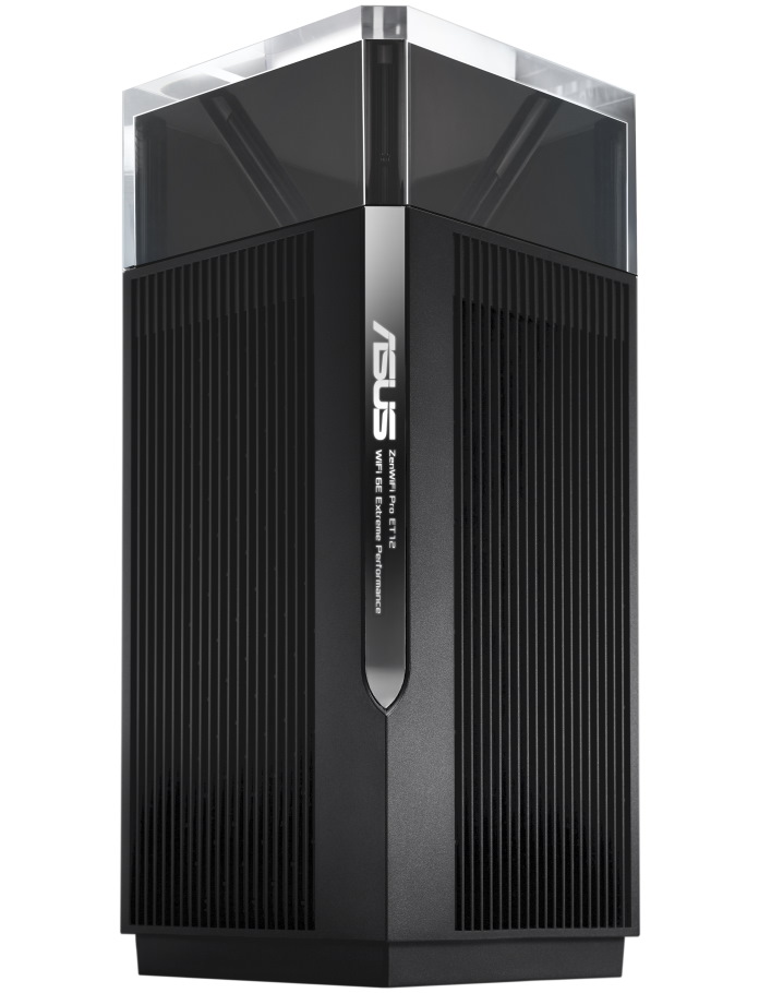

The first routers from Asus with two 2.5Gbps ports will be the ZenWiFi Pro ET12 and XT12.
L&LD
Part of the Furniture
Those are the ugliest routers I've seen so far. These may be the first two routers with 2x 2.5GbE ports that I'll be ignoring, indefinitely. :)
