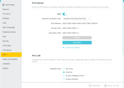

I'm having a similar issue...
I have an AX1800 Dual Band Wi-Fi 6 Router and a Toob connection
Everything looks okay in the router settings (although I confess that I don't know what I'm looking at) but online sites that claim to test my IPv6 connection say that I don't have one?
The fact that addresses are showing for IPv6 seems promising? So maybe it's something to do with the LAN settings? (but the other options don't work either!)
Is anyone here with Toob and managed to get this working?#

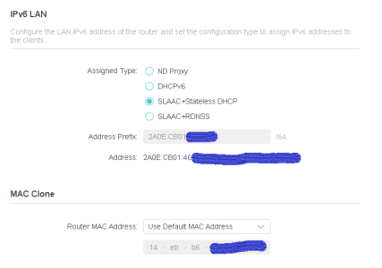

There are addresses showing that start that way in the router settings:
I had a look through all the other tabs, but nothing seemed relevant.
I'm not sure how important this is anyway? A lot of the threads that I've found on the topic are people going into their Toob router settings to turn off IPv6 (apparently runs better without it?)
Thanks for the tip on obscuring the IPv6 address in any case (have made an edit!)
