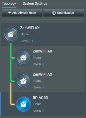

As a follow-up question: Based on my Mesh lay-out graph, the RP-AC55 garage is connecting to the XT8 mesh node on the second floor (see pic). If that is a true representation, is there a way for me to point the RP-AC55 to the router/base station at the top of the diagram, which is closest to it?

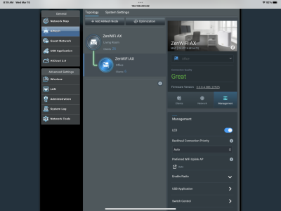

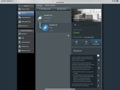

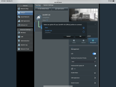

You can go into that node and set the wifi uplink priority to the main router.
