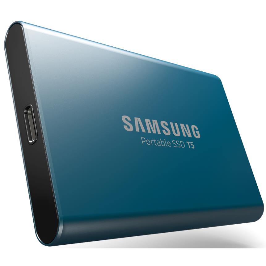

Hi Guys,
I keep burning through USB sticks and/or running into issues where the R/W speeds are subpar on the sticks causing scripts and the router to lockup. Is an external SSD such as this fine? Does it have a memory cache controller unlike those crappy USB sticks?

To answer your original question then yes, that should be faster than a standard USB drive, but here are some interesting alternatives as well.

Depending on the SSD drive you choose (if you go this way), you may have to provide a better power supply for the Router. At least for my AC86U, the 1.75A 19V stock charger was insufficient. On bootup, the SSD drive would not mount. Yet, it would mount fine if I plugged it in after the router booted and settled. The error being reported in the syslog is tied to insufficient power.
I swapped the supply out for a 2.5A 20V supply and the now the SSD mounts OK on bootup. Interesting enough, I have not had a case of the famous boot hang on the AC86U since either (touch wood - it's only been a couple of weeks, but during my 384.18 to 386.1 clean upgrade, not one hang in what must have been 20 reboots). A powered hub is another option.
