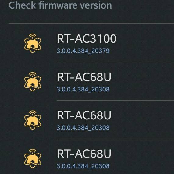

So, in short, you're experiencing issues with the upgraded f/w on a native RT-AC68U?
I have this set up with an RT-AC3100, native RT-AC68U and two converted TM-AC1900's and it is working.
I haven't upgraded any f/w.

To get this straight, the only way the f/w update allowed your RT-AC68U yo be seen as a node is if you took it off line, reset it, plugged it into a pc or laptop with an Ethernet cable, went to the GUI, updated the f/w from there then told it to be am AiMesh node?
Just trying to understand how you did this manually.

4. ac3100 @ 20379, ac68u @ 20624 after establish ai-mesh with 20308 (tried once)
instead of using the firmware upgrade button, I decided to manually upload the firmwae to ac68u only.
surprising enough that everything works normally, no issue with ai-mesh, no infinite firmware updating page nor the kernel dump.
also noticed that I have signature version @ 2062 this time instead of 2060.
For now, I will leave it as is to see if I encounter any more issue next few days.
