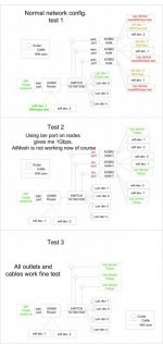

I have an Ai Mesh setup which is explained in the diagram. The question is why do I have only 500mbps on the nodes through cable connection . I tested all three nodes and all behave the same. I also tested all other cables and outlets and all work fine.

It would help to describe your setup in the post itself. The attached image is too small to read easily.

best i can see, it looks like a AX56U at the head and AC66u distributed.

I have main router - switch - nodes hard wired.
