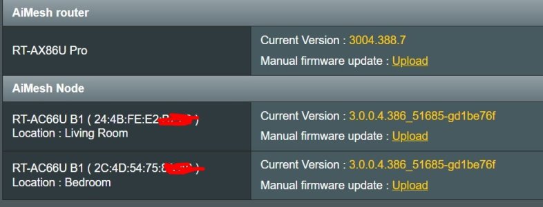

I have two RT-AC66U B1 as AiMesh nodes running 3.0.0.4.386_51685 without problems.
