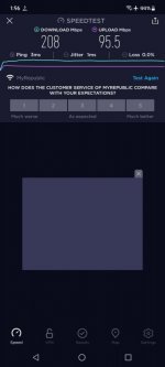

Picture one when i connected to my node

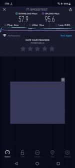

When i back to connect the main router

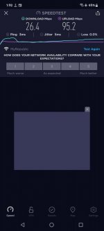

After DC and Reconnect to the router
You may try to change the LAN cable connecting the 2 routers check the Mesh menu in the Ax56u page you see there the connection type and speed ( if any) if you don't have cables attached maybe the distance is too big and the connection is not that strong in order for the second router to run at full speed
