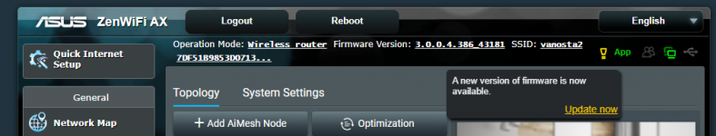

3. When I browse to my Zenwifi (either from a PC in a browser or from the app on my ipad or iphone), it keeps telling me firmware upgrades are available (and clearly important as the setup keeps telling me to make sure the latest firmware is installed). But when I try to do the upgrade, it always fails. On my Ipad, it goes through a 7 minute procedure and then tells me it failed, try again. On the PC it just says 'downloading firmware' with no progress or next steps, even after a few hours.

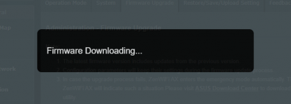

The router / base station of the Zenwifi is connected to the modem by ethernet. The connection is 100% rock solid. The devices I am trying to use to drive the firmware update are within line of sight of the zenwifi and Ookla indicates around 500 mb/s internet speed. Even if I manage to download the firmware update from asus, I don;t see how to get it onto the zenwifi once I have it downloaded to the laptop.
I only see a link on the GUI of the zenwifi to update firmware but there is no option to pull it from my laptop. Instead it goes straight to 'downloading firmware' and then nothing happens. That is what I meant by wanting to update the firmware manually.

What happens when updating your main router in Administration -> Firmware Update?
You can update the AC68U nodes the same way before you add them, to latest stock Asuswrt.
pvanosta
nothing happens. In the GUI it shows there is an update available. Click on the link. Next screen shows button to update. Click on it. 'Firmware Downloading ...' and then nothing. For shirts and giggles, I left the screen for 24 hours and no movement at all...
