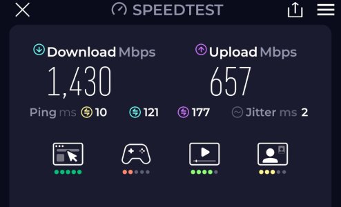

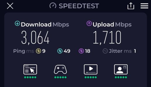

My current testing device to test speed is my OnePlus 13 which supports WiFi 7 supports 320 Mhz, near router I got 3064 down and 1710 up, a few ft away is my room I got 1430 down and freaking 657 upload WTF, none of that represents 5 gigs down 5 gigs up... Does this RT-BE92U router suck? and should just sell it and get the ASUS RT-BE86U or the fact that I'm near the Naval Base also has something to do with my speeds here?

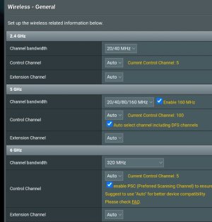

Have you tested with a cable connection? What "features" have you enabled? What other settings have you changed? What firmware? What's running in the background on your phone? You've not really disclosed a lot of essential info so we can only guess.
I don't have a computer to test with Ethernet and I don't have one of those USB C to Ethernet adapters that can do 5gigs etc... I have one but only does 1gig and I also don't know what's my phones max speeds with such 5 gig adapter....
Features I got the AiProtection on, qos off
Firmware installed latest from Asus installed last night
When I do WiFi speed test no other app is running except the speed test app....

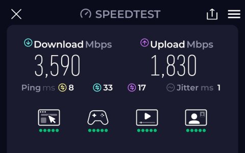

I turn off AiProtection and withdraw from the two policies on Policy tab
