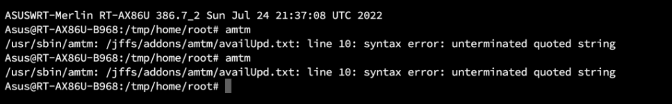

Hello,
After installing an addon i got the following error, when trying to access amtm:
ASUSWRT-Merlin RT-AX86U 386.7_2 Sun Jul 24 21:37:08 UTC 2022
Asus@RT-AX86U-B968:/tmp/home/root# amtm
/usr/sbin/amtm: /jffs/addons/amtm/availUpd.txt: line 10: syntax error: unterminated quoted string
The addon in question was VPNMON-R2 v2.24b4.
The router is working as it should, apart from the error...
Apart from reinstalling from scratch amtm, what can i do?
Thanks for the help

Perhaps go into that /jffs/addons/amtm/availUpd.txt file, and fix that unterminated quoted string? Perhaps even post it, and we can let you know what you can do to try to fix it?

I got this error:
GNU nano 5.7 availUpd.txt Modified
unbound_ManagerUpate="-> v3.22
3.22
3.22
3.22"
unbound_ManagerMD5="6b4a500c071bcbb3f4a6e9596a178d43"
scMerlinUpate="-> min upd"
scMerlinMD5="08d2472ead23674ca30bb7cccc3b15e4"
spdMerlinUpate="-> min upd"
spdMerlinMD5="25c5e28ebddcd774bc0466eb5f10fd3e"
2.22"

I would try this... looks like something got borked.
unbound_ManagerUpate="-> v3.22"
After you make this edit... CTRL-O + enter to save... CTRL-X to exit... then try running AMTM

Thanks, it is working...
