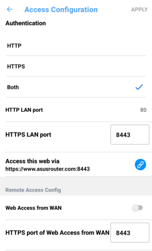

Yes, that is what i want to do. 1 last question when you said "Asus App will offer you remote access after installation, decline it. This is what opens Access from WAN on the router and is not recommended for security reasons." Are you talking about this from my screenshot?

I can't find a screen like you show in your prior post. I run the Asus app on an Android tablet and an iPhone and there is nothing like it. My AX86U Pro GUI does not have that shot.
Yes, keep this Web Access from WAN disabled, use the VPN network access options discussed above instead. You can disable HTTPS access and use HTTP only from your LAN. Encryption of your own LAN communication is not really needed and it may slow down your WebUI.
