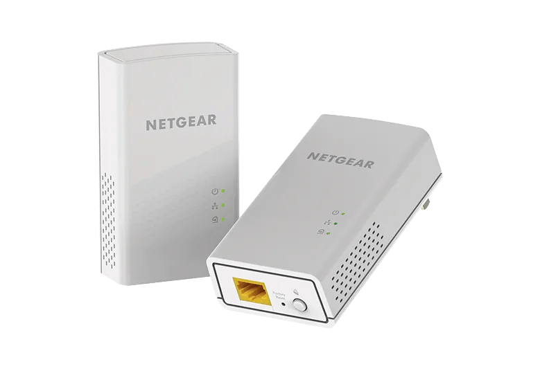

try a pair of netgear powerline 2000
i had good luck with some 40 year old wiring in my mother's house. Used as backhaul for a pair of ASUS 68 AC wireless routers. Best i recall, getting 2-300 Mbit/s
You have to have a 3 wire plug though (L-N-G)
Make sure you buy from a store that will take back , no fee, if they don't work.
