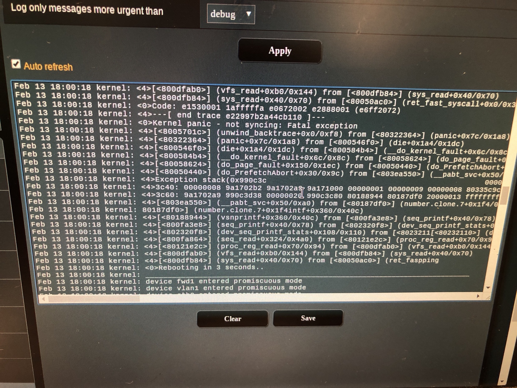

Try this mate? It just restarted before I pulled this log...
-Blaine
Assuming a kernel panic isn’t good... but why? :-(
-Blaine

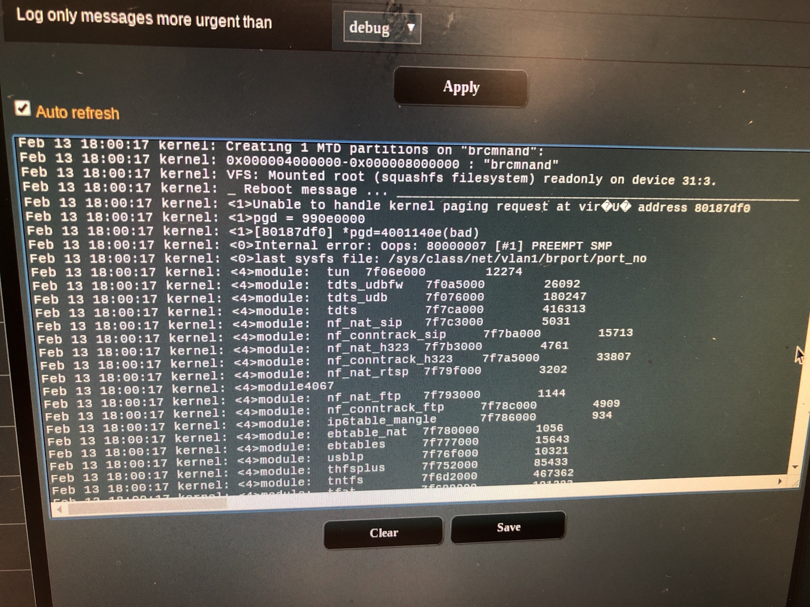

Thanks for the updated syslog. Unfortunately there's nothing immediately obvious as to the cause of the reboots. The kernel panic messages have been seen before in various scenarios, they indicate the symptoms rather than the cause IMHO. You might try reformatting the JFFS partition just in case that helps.
Other than that I suggest you try the latest beta firmware from Merlin. That build was synced with the GPL release of your previously stable Asus firmware, so that looks hopeful.
It looks like you have a bad flash memory....try reloading the code via the Recovery Tool or CFE mini server.

This part looks kind of important. How do I figure out what that virtual address is??
