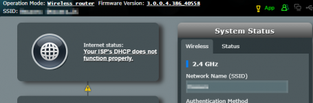

After digging in the logs, and checking the GUI, I noticed the following errors (see attachments), this looks like it might be an issue related to the ISP (Telenet in this case).
