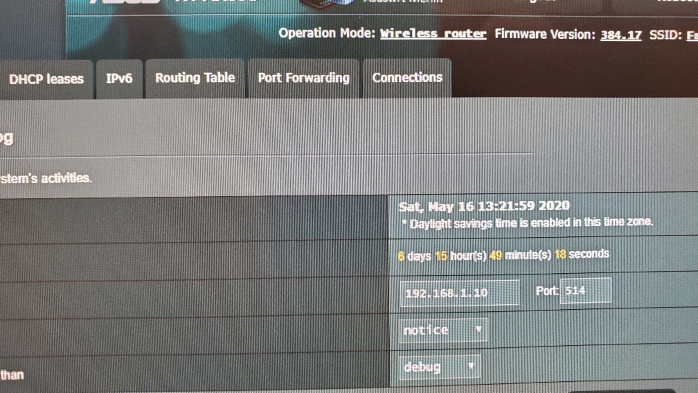

Im not sure what could be happening. I updated to 384.17 six days ago and has been rock solid on my unit.
