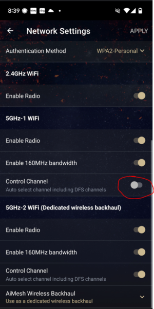

Do ALL of your wireless clients support the DFS channels?... typically not. If not, then you may want to deselect '... including DFS channels' to prevent the firmware from using a DFS control channel for those clients.
Oh, I thought I have to check the DFS box for router to use *any* DFS channels. You meant it's only for placing control channel on DFS channels? Everywhere I read on enabling DFS channels mention checking the box. But regardless I know most of my clients (laptops and phones) can connect to 160MHz (I used wifiman to check on each)
The channel setting (Auto or fixed) is for the control channel. If the control channel is DFS, legacy clients that can't use DFS channels won't connect. To accomodate them, use a non-DFS control channel... then only the extension channels will use neighboring DFS frequencies to achieve 160MHz bandwidth.

Sounds good. Based on earlier post I already turned off DFS control channel check box. But unfortunately the interface does not allow 160 + auto control + no DFS:
Current:
If I select 160 only, the DFS is preselected
I could fix it on 44 though:
Which is better? May be I should leave it in current and see how it performs for a few days. Previous I've always end up control channel on DFS.
Current:
That UI can be buggy... .sometimes it can't 'get there from here'. Try making the settings in a different sequence and/or save intermediate settings first before making the final settings. I have seen this approach change which settings get offered for the user. There is no reason you can't fix a non-DFS control channel in band 1, and fix 160MHz bandwidth. Play around with it... it should get there.

No dice, tried multiple ways / intermediate saves etc all end up with the DFS control preselected if channel width selection is only 160mhz.
Anyway I'm moving on for now with leaving it auto and let it drop to 80 and stay there. In the past week DFS hits almost every other day.
