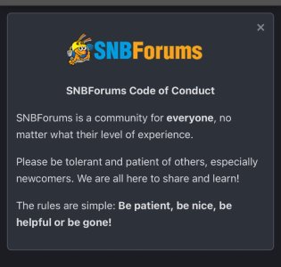

Then why are you here? This forum is for those using custom firmware and custom scripts that help make stock functionality and features work as intended, or go beyond.
There's no need to be rude. His point was a valid one: you posted about the stock firmware in a section dedicated to a third party firmware. Since both platforms have completely different issues and solutions, it would have been less confusing to post your issue in the appropriate section.
You are a staff member and you have amazingly missed all the below
1. The fact that I am merely repeating what the Code of Conduct reads
2. The fact that I am in fact responding to a rude comment
3. The fact that I am not the OP and didnt therefore choose the section where this issue is placed in the forum
4. The fact that the rude comment you almost intentionally missed above questioned why I am on the forum, not the section
5. The fact that the OP found my posts useful and agreed
