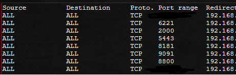

Sorry. Yeah, I guess that would be better. Um. Under the port forwarding tab it has this? I blacked out two ports as those must go to my two plex servers. However all the others listed go nowhere. Like to an internal IP of an old server. What aren't my ports listed here!

ColinTaylor
Part of the Furniture
Sounds like there's still something messed up with your router's NVRAM if it's showing stuff that you had previously setup. After you installed your current firmware did you remember to do the factory reset?
