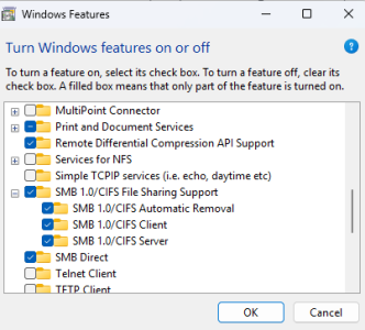

You can always enable SMB1 in windows, that should solve the problems.
At this address you have a description of changes in Windows 24H2 regarding SMB:
LINK

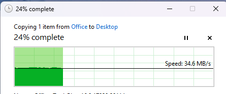

I have a third computer still running 24H2 and I've enabled SMB v1. It makes no difference. Still getting 30-40MB/s.

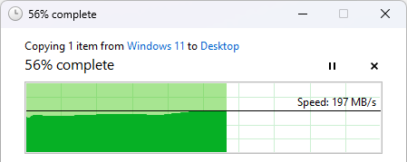

I have found the solution😍😍😍 on a website called winaero.com:
Run these commands as Administrator:
reg add "HKLM\SYSTEM\CurrentControlSet\Services\LanmanWorkstation\Parameters" /v RequireSecuritySignature /t REG_DWORD /d 0 /f
reg add "HKLM\SYSTEM\CurrentControlSet\Services\LanManServer\Parameters" /v RequireSecuritySignature /t REG_DWORD /d 0 /f
I'm now getting speeds between 190-202MB/s. Excellent! See attached photo.
