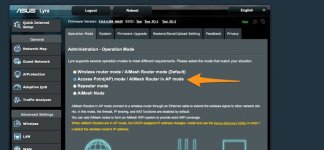

I've reset all to default and put the newest firmware:
3.0.0.4.384.46630 2021/05/14
So, with older, beta FW (
9.0.0.4.384_46629 BETA 2021/02/05 ), I got this:
With the newest fw ( 3.0.0.4.384.46630 - 2021/05/14) I got this:
Be sure to reset the firmware after you install it.
Your pic suggests a webUI tab is missing from your build.
