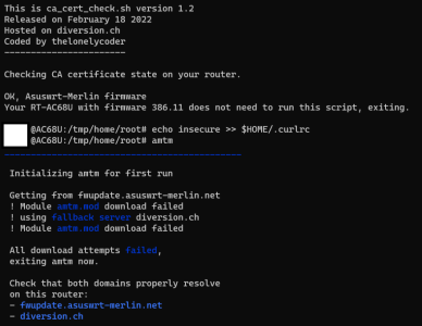

I reset my AC68U twice and ensured JFFS partition is formatted at boot. I also updated the certificates and switched to unsecure mode as per another thread. However, amtm always fails to download.
It worked fine before the reset 2-3 weeks back but since the reset I have been unable to set up amtm.
Edit: It worked only after I updated the WAN DNS server to one of the pre-populated ones. The sites resolved fine through the browser and I got a ping for both domains from the terminal, so not really sure why they were inaccessible from the router itself then until the DNS was updated.
