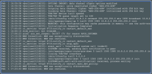

I am using a RT-AX86U, initially with the Asus Merlin 388.1, Asus Merlin 388.2 alpha 1, and now with Asus Firmware version 3.0.0.4.388.22068, and i am unable to use NordVPN or Surfshark VPN, because i set up the vpn, it works for a few minutes and then it goes down...I check the settings, and i don't get an error on the VPN setting, but i don't have any internet...
In the logs, i see a "wan down' and "wan restore" appearing after these "episodes"...
I already changed the modem of my internet provider, resected the router with the official asus firmware and the issue still goes on...
Any device that i set up to use the vpn, get's disconnected, the devices without vpn work without issue (that i can see)...
It started last week, before that, didn't have this issue...
Any help will be appreciated...

I think i found the issue, i disabled the " Network Monitoring" option, last night, and i haven't had the issue again, even after a few hours...
I will see in the next days, then will "upgrade" to merlin firmware again, to see how it goes...

Upgraded to Merlin, and the issue is gone, just had to disable the "network monitoring" option...

The issue is gone because of disabling Network Monitoring. It's a known workaround - works for some, but not always. Current stock Asuswrt is much newer firmware with many fixes after latest available Asuswrt-Merlin 388.1 and you actually downgraded to Asuswrt-Merlin.
