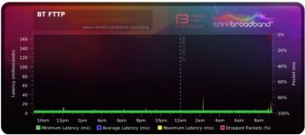

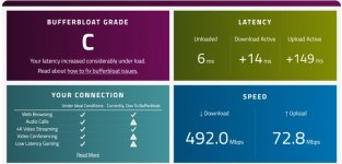

As others have said I would try a Thinkbroadband BQM on your line. I don't do gaming and have never used QoS as I've not had any issues - I do a reasonable amount of Teams/Zoom (although some over my work corporate VPN) and use a VoIP landline with no issues.
But just for comparison the attached shots are of my Openreach FTTP line with BT residential/retail 500/75 service through an RT-AX88U on Merlin f/wm no QoS etc. On the BQM you can just see the effect of the several Waveform tests I did on the right hand side.
I also note in your OP you've got an RT-AC66U - I think these were released 2012/13 and no longer supported under Merlin. It's not going to have the grunt for QoS on faster connections but may cope with basic h/w accelerated NAT. You'd probably be better off with an RT-AX68U or similar newer router, you may even find the (if you go with BT) BT hub performs just fine.

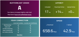

For comparison, here are my results using Virgin Media on a quiet network. No QoS, AiProtection, etc. If you're only getting a "C" grade in the same circumstances that's likely the best you'll ever get unless VM fix their network.
What bandwidth values did you use when testing the various QoS options? To figure out if QoS can help your connection, try an extremely low value (e.g. 10 Mbit down, 5 Mbit up). If you still have bad results, it’s likely not something you can control from the router.

Thanks for the reply. Looking at your BQM, you have a very stable and clean connection. Your bufferbloat results look really bad but that would be fixed with QOS/SQM. That gives me hope as maybe most of my issues are from my Virgin Media connection. I'm a signed up to Think Broadband so that I can see a BQM of my connection.
I'm actually looking into a RT-AX88U right now too, what a coincidence. I think this with maybe CAKE SQM script installed could achieve A+ in bufferbloat tests, so as long as my connection is good enough - if not, I still want to upgrade to that router along with BT FTTP 500.
Your router is not replying to pings, hence the solid red which is 100% packet loss. You may need to find the "reply to pings" setting on your router and turn it on.
