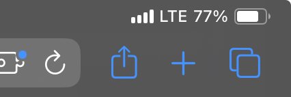

Going to give this a try, I have an iPad that jumps around like crazy and half the time I switch off Wi-Fi and use cellular. Like now - this is with Wi-Fi on!
